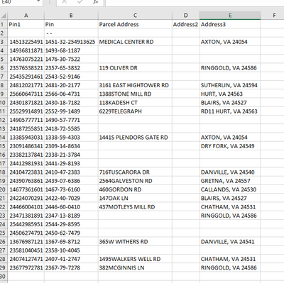

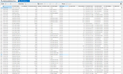

I would like to automate a process to copy, reformat, and join tables to a feature class.  I have an idea of how to implement the process in Modelbuilder, all except reformatting the tables (attached snapshots).  The original tables are Pipe delimited.  The attached files are the final result of reformatting them in Microsoft Excel.
Does anyone know of geoprocessing tools that can be used to reformat the original tables into a usable format as such?

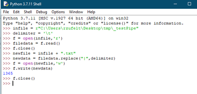

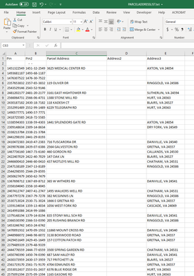

Looks like if you make it a tab separated file, should work for you:
infile = r"C:\folder\tmp\_testPipe"
delimiter = '\t'
f = open(infile,'r')
filedata = f.read()
f.close()
newfile = infile + ".txt"
newdata = filedata.replace("|",delimiter)
f = open(newfile,'w')
f.write(newdata)
f.close()

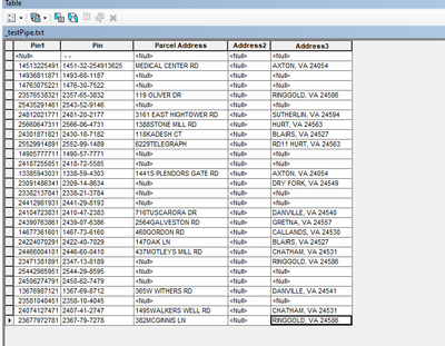

Input data:
Then, in Excel:
ArcMap:
Pro:

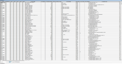

Hmmm, when I ran the script this time, it only separated out the last column (see attached).
 Thank you so much for helping!
infile = r"C:\TEMP\PRC\PARCELADDRESSLIST.csv"

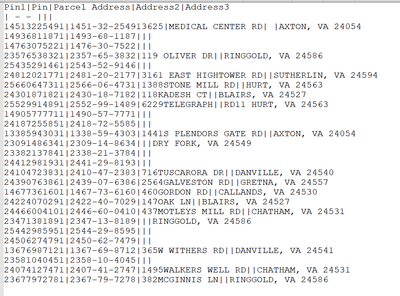

Can you post the original pipe file (like you did with these csv's) instead of a pic of them?  Would make it easier to see what is going on.
R_
BarryG
Attached are the original data dump files. Thanks!

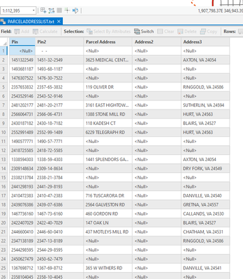

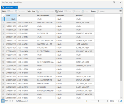

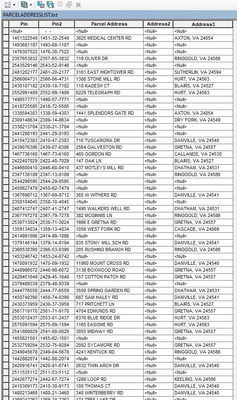

Dowloaded the files, Renamed Pin to Pin2, also in the PRCDATA, had to rename the second BLDG NO to BLDG NO2 (surprised there are not more issues as Arc generally doesn't like spaces in field names) as there were errors trying to bring a table into Pro with duplicate field names.

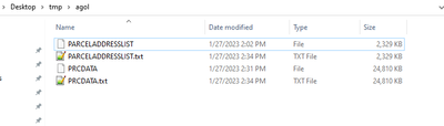

Kept them as pipe delimted file with no extention as supplied:

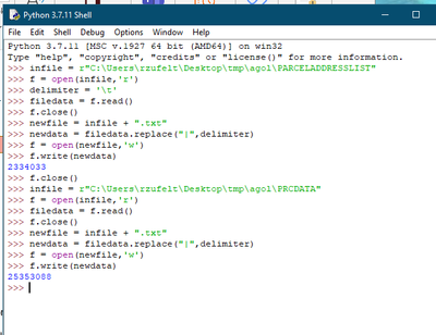

Ran the code:
which saved the new files with .txt extention:

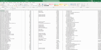

Open the new .txt files in Excel:
In ArcMap:
In Pro:
Only issues it had were the duplicate column names Pin and BLDG NO.
