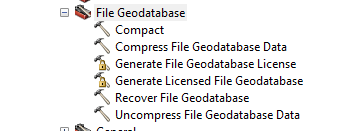

UPDATE - I guess I lied. I have a default gdb. How do I create a new one? Can I use my existing map or do I have to create a new map?
This is all I see
JoeBorgione

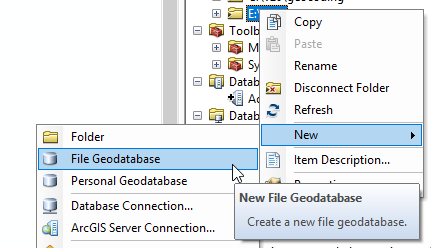

BradNiemand
Elizabeth,
All you need to do in ArcMap is right click in any folder in Catalog and select New > File Geodatabase
As far as I know, everything else would still be the same.  The only difference is writing to and reading from the FGDB now.
Brad
