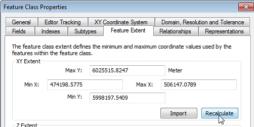

I have hundreds of feature datasets that have incorrect XY entents (unknown reason as to why), but I am hoping to save time by automating the pressing of the 'Recalculate' button as seen below:
Does anyone know of a tool that I can run with an iterator to run over each of my feature classes???

The arcpy tool to do this is Recalculate Feature Class Extent​.
arcpy.RecalculateFeatureClassExtent_management(feature_class)
You will still need exclusive lock on the feature class, but it should do the exact same thing as right clicking on the feature through the GUI.
