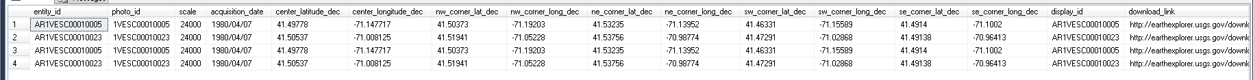

Can you attach an example of the Metadata for an aerial photo? Just to know what your possibilities will be...
JessiecarEsguerra
Sure Xander.
See attached screenshot containing a sample metadata for an Aerial photo. I tried attaching an excel file but I can't here.
XanderBakker
Esri Esteemed Contributor
The corner correspond to the fiducial marks? Are these always in the same location (row, column in the digital image)?
NeilAyres
MVP Alum
I very much doubt it. These are photos later scanned to get them into an image file.
The pixel coordinates will depend on the position through the scanner.
I very much doubt there will be any correlation between pictures as to the exact pixel locations of fiducial marks.
However, you do seem to have the picture centre in Lat/Long. Perhaps something could be engineered out of that.
XanderBakker
I have my doubts too, but with some numpy executed on corner rectangles with a certain extent, i think these marks can be identified and can be tied together with the metadata. Would be interesting to try this...

We have actually tried a few photos and it was georeferenced on the right location though there's a slight misalignment which I think is expected since these are Historical photos.
