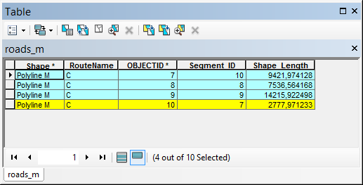

trace: C  starting @ 7
lst_processed: [10]
 - GetCandidate 1: None None 9999
 - GetCandidate 2: 8 start 0.0
 - candidate is at start of line, requires flip of current oid
 - adding current oid  10  to flip list
lst_todo [9, 7]
lst_flip_oid [2, 6, 10]
lst_processed: [10, 8]
 - GetCandidate 1: 9 start 0.0
 - GetCandidate 2: None None 9999
lst_todo [7]
lst_processed: [10, 8, 9]
 - GetCandidate 1: 7 start 0.0
lst_todo []
lst_flip_oid        : [2, 6, 10]
lst_candidates_todo : []
lst_multi_candidates: []
 - Route: A   seg id order: [1, 2, 3]
 - Route: B   seg id order: [4, 5, 6]
 - Route: C   seg id order: [7, 8, 9, 10]

ZenekS_
Xander, your programming skills are awesome :-). The code makes exactly what I want, and even more - it creates a new feature dataset with corrected directions.
But to answer your question. Yes, in this case, we can assume that M values are also the roads lengths.
So, what I now have to do is to reverse the M values of segments identified as a "Flipped" to be increasing with the right/changed direction. Once I changed the direction the M values are automatically decreasing with direction, and they should be increasing.
As I said before, I know how to make it manually for every segment (RouteEditing Toolbar) - screenshot below:
But maybe can it be doing automatically ?
XanderBakker
Esri Esteemed Contributor
I'm glad it was helpful. Always nice to have a challenge.
Just wondering, if you use the tool Create Routes—Help | ArcGIS Desktop it will dissolve the segments and it can generate M values based on the length.
The code can be adapted to create M values based on the distance along the line. I can toss some code your way to show you how that can be done, but it might slow the code down. Let me know if you want the snippet and I can post it.
XanderBakker
The "fast way" of inverting the correcting the M value is:
    polyline_out = FlipPolyline(polyline, True)
def FlipPolyline(polyline, correct_m):
    sr = polyline.spatialReference
    length = polyline.length
    vertices = []
    for part in polyline:
        for pnt in part:
            if correct_m:
                pnt.M = length - pnt.M
            vertices.append(pnt)
    polyline_out = arcpy.Polyline(arcpy.Array(vertices[::-1]),
                sr, False, True)
    return polyline_out
