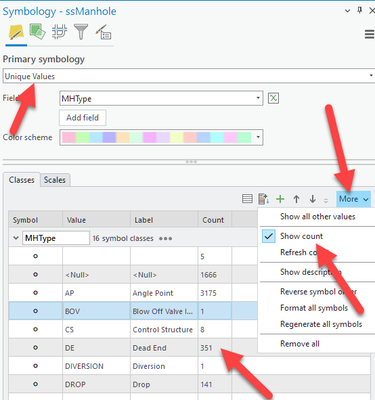

RhettZufelt
MVP Notable Contributor
Depends on how "simple" you want.
One simple way is to load into Pro/ArcMap and symbolize on the Phase Configuration field, then select Show Counts.
R_
