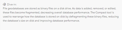

From the compact help page:
swap out the following in my code:
#replace:
arcpy.CompressFileGeodatabaseData_management(fgdb)
#with
arcpy.Compact_management(fgdb)
That should do the trick for you....
