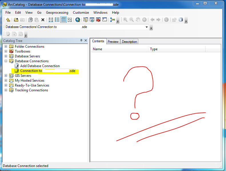

We are experiencing a rather weird bug/behavior when trying to add a database connection in ArcGIS Desktop 10.3.1 (ArcMap or ArcCatalog) to a PostgreSQL database (version 9.3.9) which has the POSTGIS extension installed (version 2.1.7 r13414 ). The connection succeeds without any errors in ArcGIS but when we look at the contents pane it is completely empty but should be full of tables with data (see image below).
A database user has been created to make the connection and this user has been granted all the necessary roles/permissions in order to at least view (SELECT) data in this database so this can not be the problem. We have also tried connecting as the database owner/database admin user and the same problem is present.
