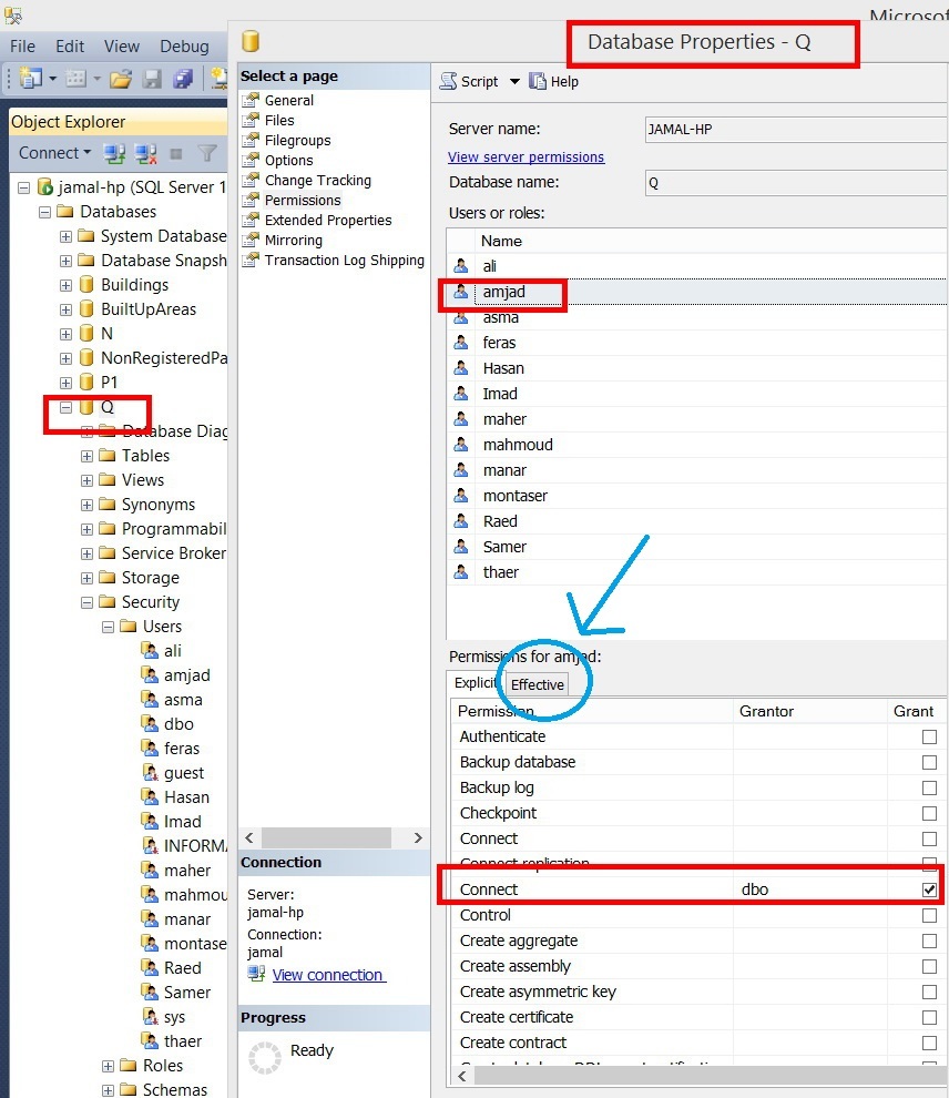

JamalNUMAN
Legendary Contributor
“Amjad” has only “connect”, nevertheless, he can View and Edit the data!
