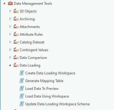

Starting with ArcGIS Pro 3.2, the Data Loading Tools are now included with ArcGIS Pro. You no longer must clone your python environment and install the tools via Anaconda.  The tools are available in the Data Management Tools toolbox, under the Data Loading Tools toolset.
As we moved the tools into ArcGIS Pro, we made some modifications that are highlighted below:
Create Data Loading Workspace
Only the names of the parameters have changed.  No other tool changes.  There have been changes to the Data Loading Workspace, which are noted below.
Generate Predefined Mapping Table
This tool has been renamed to Generate Mapping Table and the names of the parameters have changed.
Execute Data Load
This tool has been renamed to Load Data Using Workspace.  The names of the parameters have changed and the Preview option has been removed and replaced with Load Data to Preview tool.

Append with Transformation
Append with Transformation was removed due to some overlap with future plans for Append GP tool. We did not want to add it into Pro only to retire it soon after. However, the underlying logic for Append with Transformation is still there. Attached is a toolbox that works with ArcGIS Pro 3.2 and greater that provides the Append with Transformation GP Tool.
