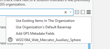

JenniferBorlick
I'm not seeing "Use Existing Items"?
JenniferBorlick
Found it.
MikeDagle

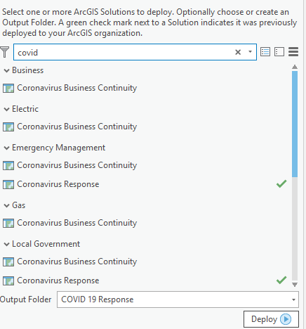

Hi Jennifer - It's in the hamburger Options menu to the right of the search box. Just above the scroll bar.

Got it. Thanks. When I attempted to re-deploy, it said that it finished, but instead of a green check mark, I got a red X.
I went into the organization and nothing had been overwritten. I deleted the Cases feature layer and the survey (The survey from Survey123 Connect) and tried it again. It worked the second time. My guess is that there was a schema lock. Let's hope I don't have to do that again.
