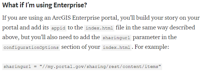

I built a really simple Story Map Journal in both ArcGIS Online and Portal for ArcGIS to test, and followed the steps outlined by Cooper Thomas in his blog post. Since I'm not using WAB for Developers, I had to download the source code from GitHub and I think i followed the instructions correctly, that is - until I got to the last part and became instantly lost:

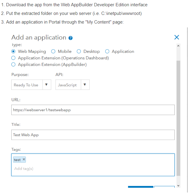

So, after some more research, I found another post on How to Publish a custom WAB application to Portal. Which initially gave me hope because @JakeSkinner provided this awesome screenshot that made things seem clear.
So I copied the custom code to my server, and followed the same steps as above and successfully added the application to my Portal (brief moment of success).

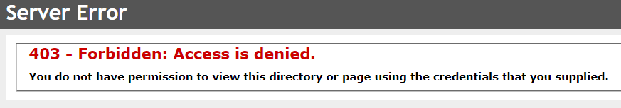

When I open try to view the application, I get the following server error.
Any idea what I should do from here?

Hi Chris -- Have you set up oAuth for your version of the hosted app? That might be it. You can review this article to find out how to do that and it might also give you any insight into what else might be going on.
https://medium.com/story-maps-developers-corner/an-introduction-to-hosting-your-own-story-map-e24501...
If that's not it, it can be tough to troubleshoot web server issues like this given there are so many possible configurations. I'd suggest you open a ticket with Esri Support and they'll be able to help.

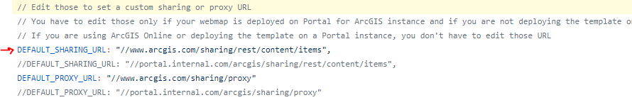

So I think I found the proper spot in the apps/config.js
So I updated this with my Portal URL, and I get this:
