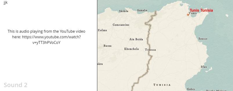

My goal in making a story map right now is to play the AUDIO from some of my YouTube videos.  The code below works just fine - it links to a javascript file and the YouTube API accomplishes what I am seeking – Here is a sample page of how that works here: pixelright.com/joseph.htm  and below is the code that makes it work.
That’s all good and it works great!  … outside the story map.  But inside the story map, it looks like the graphic below ... it is not hyperlinked.  I feel I'm so close and just need to remove some of the DIV code but ... not sure what to change and I've tried it many times with many versions of the code below.  Thank you for any assistance!
This is what it looks like in the story map

Are you embedding the page into the map journal; your example page worked for me? Or are you trying to add the HTML directly to the map journal using the HTML editor in the text editor? For security reasons, we restrict certain tags from being added to the HTML, including those script tags: Supported HTML—ArcGIS Online Help | ArcGIS.

Hi Joseph, I'm not sure I understand what you're trying to do? Are you having trouble embedding your page with the sound? Here's a sample I made with your sample page it seams to work: http://testing-story.maps.arcgis.com/apps/MapJournal/index.html?appid=9d11cf75820d430c929f9aa370d6ed....
Or are you to get the URL to youtube be a clickable link? If that is the case, you'll need to add an anchor tag around the URL.
Here's another way to add audio to the Map Journal: https://developerscorner.storymaps.arcgis.com/using-the-html-audio-tag-in-your-story-map-f818d931625....
You might also use Sound Cloud instead of YouTube. They will host your audio and provide an embeddable audio only player. I created a second section in the test map journal I sent so you can see what it looks like.

What I was trying to do was link directly to the YouTube audio.  I can do this just fine on a web page outside of my story map, but inside my story map, I am not sure if I need to take some of the DIV lines out - but anyway, I cannot get it to work.  So, I am going with my Plan B for my Sounds of Planet Earth Story Map, which is to download my YouTube videos, separate the Audio and Video, place the Audio files online (I am using Archive.org now but yes, I also have a SoundCloud Channel), and link to the sounds online.  It is a ton more work because of all of the separation and processing required, so I was just trying to save some hours/days in my workflow.  But I've tried my Plan A a dozen times and now need to move on.  But thanks for your help!   It will be great when it is done and Plan B isn't so bad because I will have an archive of some of my key sounds as another deliverable.
