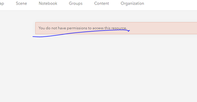

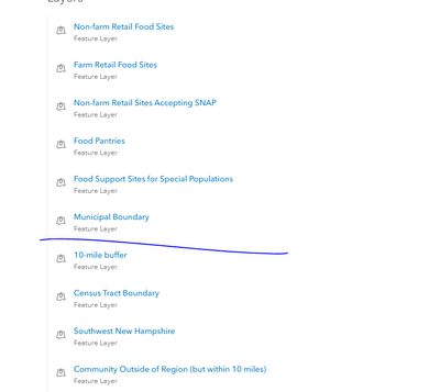

HenryUnderwood1
I ran into this one today and it turned out to be an external map service below:
When I clicked on that item I got an error message:
Strangely, the map seemed to display the layer just fine. I removed the layer from my map and added a new WMS layer (https://tigerweb.geo.census.gov/arcgis/rest/services/TIGERweb/Places_CouSub_ConCity_SubMCD/MapServer...)  and now I do not receive the login message anymore.
