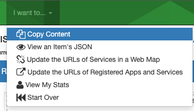

I found a method slightly simpler than @JTLancer, though it still requires navigating to https://ago-assistant.esri.com/ where you need to be very careful you don't break anything. Here's what I did
Under "I want to..." click Copy Content
Then drag the item from the left pane to the right pane where it says "Drop items to copy to this folder"
And that should do it! At least thats what worked for me.

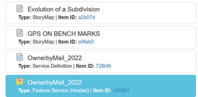

ElisseDeleissegues1
I am signed into ago-assistant and Copy Content does not include StoryMap as an option. The StoryMaps I am interested in copying are all created with the newer StoryMap builder.
I don't see that Dashboards or Web Experience Apps are an option either. Is there a trick to this that I am missing?
OwenGeo
Esri Notable Contributor
@ElisseDeleissegues1 From your screenshots it looks like you are using the original version of this tool (AGO Assistant). There is a shiny new version available called the ArcGIS Assistant. Check it out here: ArcGIS Assistant (esri-ps.com)
Please note ArcGIS Assistant is not an official/supported Esri product, but it can be helpful for certain workflows. Please be sure to read the user guide and warnings page for helpful information about using this tool. You can also learn more about using the new ArcGIS Assistant to copy StoryMaps here: Common Workflows | ArcGIS Assistant User Guide (esri-ps.com)
