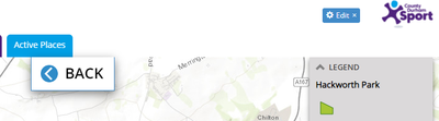

It's been great to be able to edit the styles, etc. however, I'm stuck on one thing: I'd like to get the 'edit' button that appears on the top right of the story map to disappear, like it does when they're hosted via AGOL and you're not logged in.  Is there any way I can do this? (screen shot below, and the URL to my story map is here: https://www.mapitout.co.uk/CDS/index.html?appid=0e5b0f8a85d1459395993cbcce7d0e20# )
Thanks in advance for any help or suggestions for this.

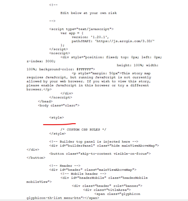

Thanks @RickeyFight .  Where would I add that?  I've tried replacing the style tag here (see snippet and screen shot below), but that didn't seem to work?
<body class="claro">
<style="display: none;">
/* CUSTOM CSS RULES */
</style>
<!-- Builder top panel is injected here -->
<div id="builderPanel" class="hide mainViewAboveMap"></div>

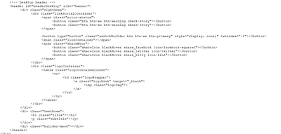

@HelenCooper  In your index.html
I think line 110. Look for a button that class has switchBuilder in it
HelenCooper
Thanks for helping so much with this @RickeyFight .  I've updated the code to:
<button type="button" class="switchBuilder btn btn-xs btn-primary" style="display: none;" tabindex="-1"></button>
but that doesn't seem to work.  When I load the page I now see a /* CUSTOM CSS RULES */ text at the top.
Sorry if I'm missing something obvious, does the style code go elsewhere around the button?
RickeyFight
MVP Regular Contributor
@HelenCooper
Did you go back and change this part back
</style>

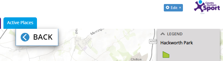

HelenCooper
@RickeyFight  Nope (facepalm), I've done that now, and it's sorted the CUSTOM CSS RULES text that I was seeing, but I'm also still seeing the edit button.
Have I got this line correct?
