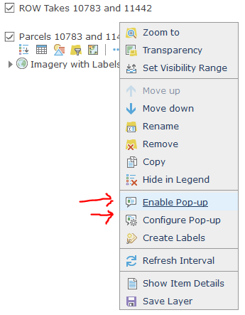

I don’t seem to have that custom config link. See my attachment. Am I in the right spot?

You first need to be able to enable popups. What kind of layer is Traditional Foods? It might need to be a feature service layer.
This article might tell more on what needs to be done in order to enable popups:
Configure pop-ups—ArcGIS Online Help | ArcGIS
(and once they're enabled, then you can configure them).

Hmmm. Its a layer I made from Add>Add Map Notes. Probably not the right kind…? All my layers were made that way. Once again, I don’t seem to have enable pop-ups.
Needless to say, I am a Newbie. That was the only way I could figure out to add a layer. So its not a feature service layer?

Yeah, map notes are virtually push pins on a map that do not allow much functionality. You will need one of the supported layers in order to configure popups.
