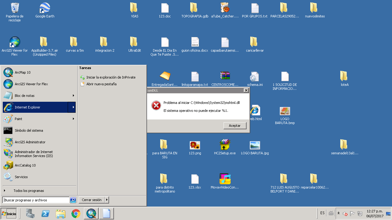

when I click de simbol of Arcgis Server manager, throw this
but it's strange, when i make app or stories maps from arcgis online page, don`t have problemas, but if i created a story map from storymaps pages, i have this problem with layer from arcgis server
