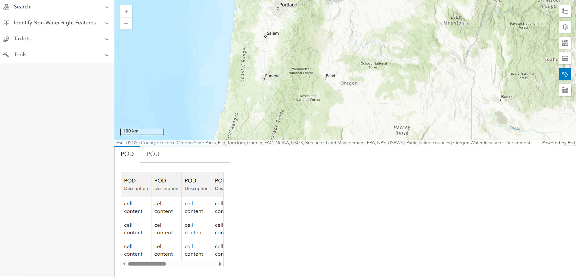

Hi,
I'm sure there's an easy way of doing this, but how do I get a calcite tab (with table) to line up with the map above it. There don't seem to be any height/width properties to use. I'm using the latest Calcite and ArcGIS Maps SDK. Any helpful tips on aligning Calcite components in general would be helpful. I know CSS files are used for much of it, but I haven't found how to use CSS for height/width properties on the components.
Here's what it looks like currently:

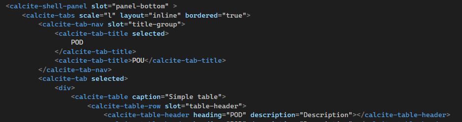

And here is the section of code for it:

@tad Can't diagnose what might be happening with more code, but the following example should work with the use case: https://codepen.io/geospatialem/pen/QwjVOaB.
Table should expand to the full width by default so there might be some conflicting CSS causing the behavior in your example above.

tad
You're right, conflicting CSS behavior. Thanks very much!
