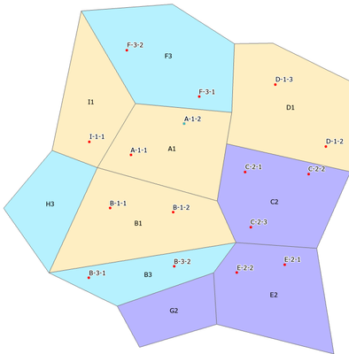

With so many sequences it will probably easier to use another approach:
// get intersecting polygon
var polygons = FeatureSetByName($datastore, "gewaesserkataster_sde.GWK_SDE_ADMIN.TestPolygons", ["TextField", "IntegerField"], true)
var poly = First(Intersects(polygons, $feature))
if(poly == null) { return null }
// get all points that intersect the same polygon, load the sequence field
var points = FeatureSetByName($datastore, "gewaesserkataster_sde.GWK_SDE_ADMIN.TestPoints", ["TextField"], true)
points = Intersects(points, poly)
points = Filter(points, "TextField IS NOT NULL")  // use only points with a sequence value
// get the next sequence count for this polygon (name and subtype)
// here, I chose "Name-Subtype-123" as schema
// edit the code according to your specification
var numbers = []
for(var p in points) {
    Push(numbers, Split(p.TextField, "-")[-1])
// if numbers is empty, max(numbers) returns -infinity
// that's why we have to max that again, so that we get 1
// if this is the first point in the polygon
var next_number = Max(Max(numbers), 0) + 1
// return the new sequence value
// again, edit according to your specification
return Concatenate([poly.TextField, poly.IntegerField, next_number], "-")
polygons.TextField corresponds to your MetroCode, polygons.IntegerField is the subtype field.
points.TextField is the field that stores the sequence values in the point fc.
Pros of this approach:
  • easy for large numbers of needed sequences
  • flexible: you don't have to change any code to add more polygons or subtypes
Cons of this approach:
  • will be slower if you have many polygons or points
  • doesn't return unique ids. if you delete the point with the highest sequence number and create a new one, the new will have the sequence value of the old
    • e.g.: delete F-3-2 and create a new point in F3. the new point will again be F-3-2; with a database sequence you would get F-3-3
