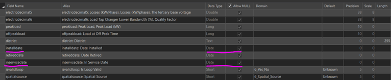

Below you can see images with the field view in ArcGIS Pro for the source class and the target class.

Source Feature Date Fields
Target Feature Date Fields
