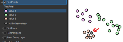

Point FC with coded value domain ["Value 1", "Value 2", "Value 3"] on TextField:
Using CalculateField, I can insert other values (same works with arcpy cursors and attribute rules):
Calculation Attribute Rule on that point fc, field IntegerField, triggers insert & update

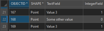

I can still input values that are not in the domain, but now the flag gets set:
