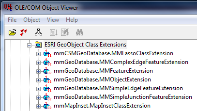

Like just about everything else, there is a COM category for that.
You have possibly 3 or more choices of how to get the extensions:
1) If you have ArcFM installed you can use MMCategoryFactoryClass which will allow you iterate through the extension GUIDs, or create instances of the extensions and get the names from the instances.
2) Use the rather limited ArcObjects CategoryFactoryClass to create instances of the extensions, and get the names from the instances.
3) Drop down to .NET or Win32 and query directly e.g. Using the COM Component Categories Manager in .NET - CodeProject

TimDine
This particular situation I don't have ArcFM.  This is a new custom class extension that populates an attribute with some custom code depending on various things, similar to an ArcFM autoupdater.
I found a good ArcGIS sample based on your option two which worked perfectly.  It now gets guid and name from the TYPE object of the objectCategory and populates them into the domain used by the tool's input parameter.  Now if new classes are added in the future they won't be hardcoded in the tool.

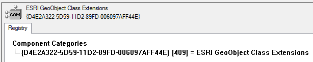

                ESRI.ArcGIS.esriSystem.IUID uid = new ESRI.ArcGIS.esriSystem.UIDClass();
                uid.Value = "{D4E2A322-5D59-11D2-89FD-006097AFF44E}"; //GUID of the Class Extension Category
