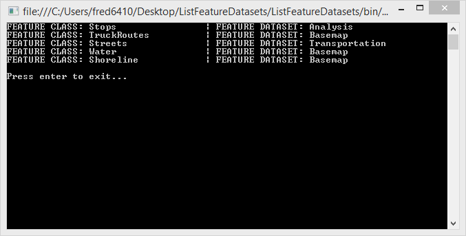

Below are screenshots of the results of these two options.
** Option A : using dictionary **
** Option B **
