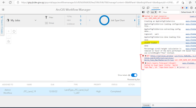

I am working on a 10.9.1 arcgis server HA set up, where the ArcGIS hosted servers 1 & 2 and Workflow Manager Server are installed on 3 different machines. All 3 servers have already been federated to 1 portal.

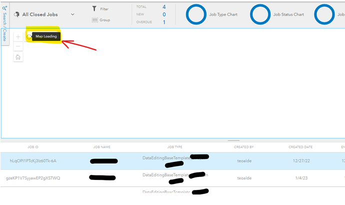

I have set the default base map in my portal to a custom base map, but this is not being retrieved by Workflow Manager Server. In Workflow Manager Server, the map view is constantly trying to call the Esri online map and failing, which is an expected behaviour since we have configured the system on an intranet. This results in the map view being stuck perpetually loading.

Update 1: It appears that the map view in the Workflow Manager Server map view will not show the base map options icon (as well as the "Manage Layers" and "Toggle Legend" option) as it is configured to only show those additional options if it is able to display a base map.  However, as the map is constantly stuck at a loading state, the option to change the base map to the ones I have uploaded into my portal will not appear. Is this expected behavior?

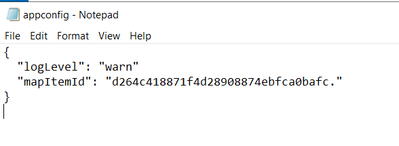

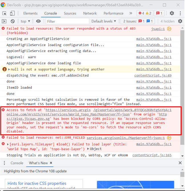

Hi Ranga,

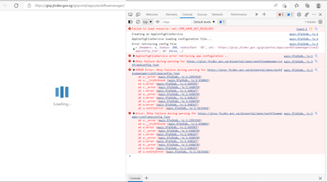

Thanks for the link. I tried the solution presented in it but my Workflow Manager web app did not load after I changed the config JSON file. I've attached the screenshots below:
btw, I also tried out 3 diff variations of how to type the mapItemID, including:
- "<item_id>"
- "<item_id>. (this is how it was written in the url you provided)
all 3 variations of writing the item ID in this config file still resulted in the same error as seen in the screenshot of the browser above. I took the mapItemID from the map item's portal URL:
Thanks!

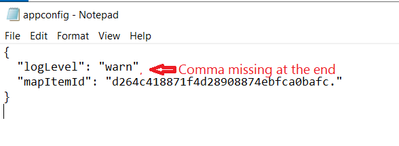

Hi Eva,
In the appconfig.json, comma was missing after the text "warn", refer to below screenshot. Try adding a comma, restart Workflow Manager Server windows service and check.

Hi Ranga,
thanks for the quick response! I added the comma and workflow manager web app was able to load the config file with the new map item ID added. However, it seems like my workflow manager web app is still trying to fetch the arcgis online base map.

I have restarted all the components of ArcGIS enterprise and cleared the browser cache. However, the problem still persists and workflow manager web app is still trying to fetch the ArcGIS online map.

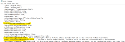

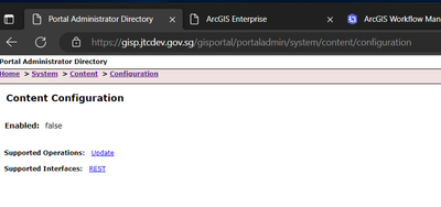

Other things i have done in the meantime include turning the portal's content configuration to 'false' and changing the AGO-related settings in the portal's config JS file (accessed from portal's installation location: D:\Program Files\ArcGIS\Portal\customizations\10.9.1\framework\webapps\arcgis#home\js\arcgisonline) to 'false'.
