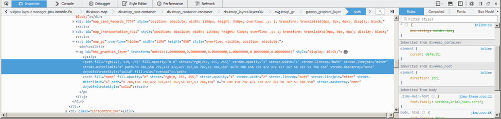

Can anybody tell me how to either a) change the color of; or b) change the opacity of the highlight/fill color for the selected result in the Search/Geocoder widget?  I don't mean how the results appear in the Search widget results list, rather how the feature appears in the map when I select it from the results list and the map zooms to the feature.  In case it matters my searches are all for polygons.
I can open the Inspector Window in Firefox and see:
But I don't see where I can change these settings.  Are they inherited from the ArcGIS API for Javascript?  If so, can I override the color or opacity?
