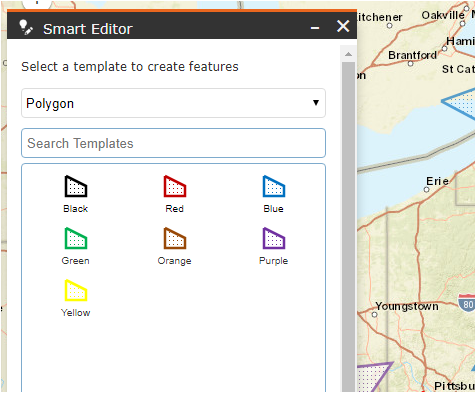

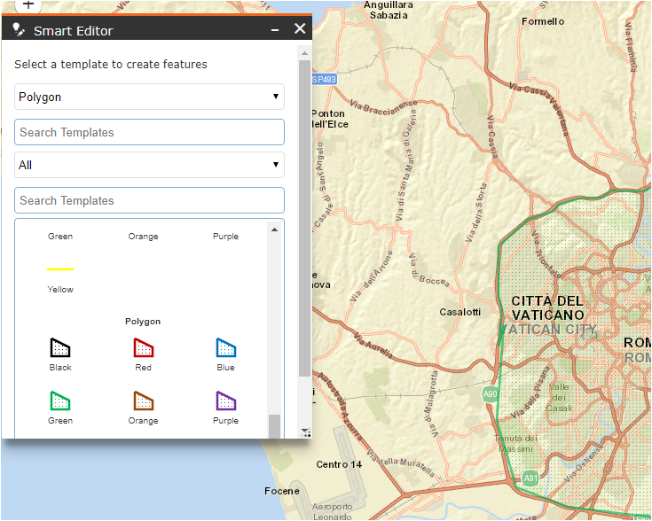

Hello all,
I have noticed that the Smart Editor Widget in WAB DE 2.1 loads the search template bar twice when a layer is chosen,  a feature is added, and then the Smart Editor Widget is closed and reopened.
Example:
  • Open the widget and select a layer to edit:
    • The layer selected is "Polygon"
  • Add a feature
    • Select "Save"
  • Smart Editor template search behaves normal
  • Close the Smart Editor Widget and then reopen it.
    • Result:
If anyone has come across this before, please let me know!
NOTE: To fix the error, the WAB app must be refreshed.
