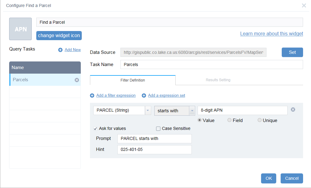

I was able to use the out-of-the-box query widget to do set up a search-by-parcel number query, which I would imagine is similar to what you want with your facility ID.   It's not as clean as the eSearch widget I use in our Flex apps, but it does work for us.
I know that doesn't resolve whatever technical issue you're having with Query, but I just wanted to reassure you that it does work. Here's a screen-shot of how I have it set up:
