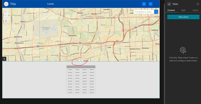

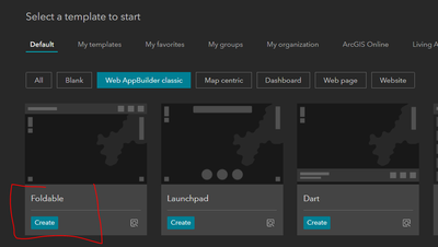

  6. Attribute Table Widget - check out the Foldable template. It uses the Sidebar layout widget where you can place a Table.

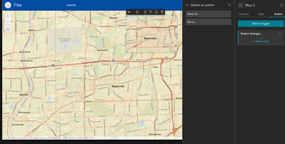

  7. Overview Map - You can use another Map widget with a set scale, and use message actions to synchonzie extent (pan to).

  6. Attribute Table Widget – Try using a sidebar element, then embed the table inside of it.  You can then set the element to be collapsed or open when the app opens.
