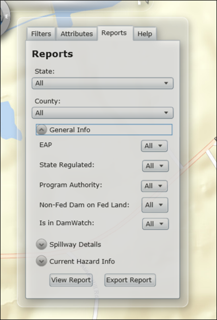

After playing with the results widget, we found that query widget has a bunch of out of the box features.  It took me some time to figure out that ALL was the equivalent of AND for all of the columns.  In the Silverlight version of our app, (of course it is not out of the box - hand coded stuff) the end users had the ability to choose which filters they could operate on as shown below.
In the picture below, the all would skip the condition for that column through a stored procedure where parameter would  @EAPParam = '' and inside the stored procedure the AND condition would be
AND (EAP = @EAPParam or @EAPParam = '') which would ensure that all EAP records are selected.

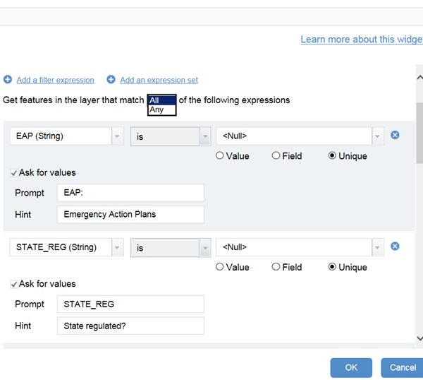

Now we are trying to implement the same app in WAB 1.3.  I was able to open up fiddler and see the GET /ArcGIS/rest/services.... /0/query?f=...... if I choose any then it becomes an OR condition and if I chose ALL
then it is a set of AND conditions. Is there a way to 'intercept' the query and check for <NULL> or '' blank values to remove those from the query stack and send the appropriate values.  I understand it cannot be done out of the box and that I have to find a js function in the wab black box.

Ravi,
   I would recommend that you use the eSearch widget as it allows for automatically removing null portions of the SQL if they are not set as required.

good afternoon.  I went through the document on the internet to set up the widget.  I added the columns for the filter optoin and chose the "unique values" option to make it a drop down for end users.
Later on, I am contemplating the use of  json to load the dropdown instead of letting widgets go through the whole table of 29000 records.  From another project (WAB 1.1, ESRI and my colleague) have a few lines of code to load the dropdown with pre-determined name value pairs.  the irritation for me is  they started on a blank temple / like about widget.  Since the eSearch widget is built, I have to see how to disable the web service search load.  Any 1 line suggestions/ pointers would be nice on this/
More important: I am getting Search Failed ! error message. I changed the URL from /FeatureServer/0 to MapServer/0 and back. I am getting the same "Search Failed !". I went through the document to see whether I had missed out any step.  I have not missed any.
is there any specific you have to suggest. I put a break point and was very glad to see that the dropdowns that had values were in the search conditions and the others column names did not show up.in the query.
