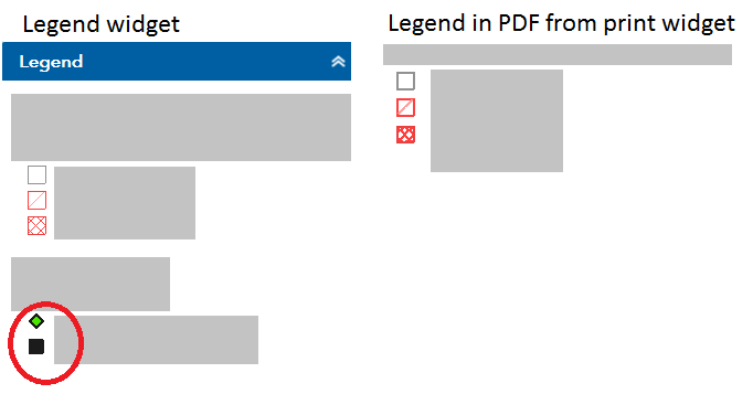

has anyone encountered issue with the Print widget where the layer legend shows in the legend widget, but it did not show when using print widget to print.
I'm having issue with the print widget, where it prints all the legends that shows in the legend widget except for one layer. what would be the potential cause for this? Thanks!!

Can you provide screenshots of the legend widget as well as how it looks through the print widget?
Ran_Deng
Hi Michael,
left is from legend widget and right is from the pdf, and the data show up in the map without any issue and no error returned when retrieving the layer.

Ran_Deng
Hi John,
it's dynamic layer. "ArcGISDynamicMapServiceLayer". but somehow only this layer is behaving this way, I republished it few times but still doing the same thing.
