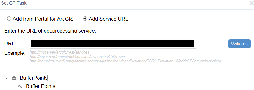

When using the WAB built in to Portal, the geoprocessing widget successfully connects to the GP services without hesitation. The validation screen looks like this and shows the toolbox with the task name underneath.

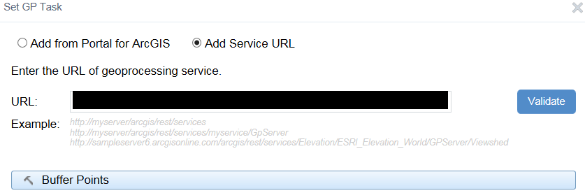

However, in WAB Dev 1.3, the GP widget stalls when connecting to GP services. After pasting the GP service REST URL and clicking validate, the task name displays but there is not a toolbox. If you choose that task and click "Set" for the task, the GP widget endlessly shows the loading bars and won't continue to the widget configuration. Tried the "Add from Portal for ArcGIS" option and got the same result. Attempted to do the same thing in WAB 1.2. Same result. Tried in other browsers, same result.

UPDATE: After multiple esri support teams working on this for a few weeks, it's officially been logged as a bug with the GP widget in WAB Dev.
BUG-000094152: Unable to configure the Geoprocessing widget in Web Appbuilder for ArcGIS (Developer Edition) when ArcGIS Server has Windows Authentification enabled on the web adaptor.
The print widget, query widget, etc., connects to GP services without any issue, but the GP widget routes through proxy.js and won't connect to any sort of service. It returns a 401 error.
