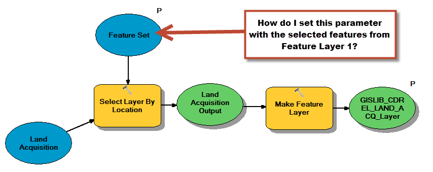

I'm looking for some guidance on what is required and where I'd need to make modifications to a Geoprocessing widget that references a published geoprocessing service with a Feature Set input parameter that will then perform a select by location process on a separate feature service layer.  The requirement workflow is:
1. Make selection in Feature Layer 1 (using the Enhanced Search Widget.  Successful doing this!).
2. Select features in feature layer 2 that fall inside or intersect the selection in layer 1.
The problem is that I cannot set the Feature Set input parameter in my model and execute this from the Geoprocessing widget.

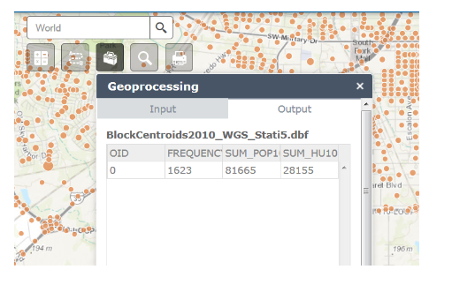

Yes, it is a point clicked on the map by the user and then all features are selected from another layer that fall within a user defined buffer distance and as a result output is a summary table.
In web app builder using GP widget task works like this:GPWidget.PNG

Oh, right.  Yes, I am aware that this will populate the Feature Set parameter!  My problem is that instead of a user-created feature (point, line or poly), I need to just pass in the currently selected feature.
As far as I know there is nothing that will accomplish this type of behavior without some extra JavaScript added in somewhere, which is perfectly fine but I need some guidance on where this should go and how it should be structured.

I was finally able to give this another try and it DOES allow for populating that Feature Set input parameter from a selected feature!  It's a little quirky in that it asks the user to specify from which layer to use, but it does work!
My problem was in expecting less click-I-ness from the workflow.  Essentially I was overlooking the input parameter selection workflow: I remember seeing "Feature Set *" but did not click the dropdown as I was simply expecting this to just work without user interactivity
