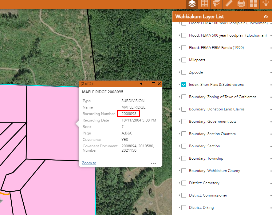

This is what my map looks like, I want it to link to the document number in the pop up window.

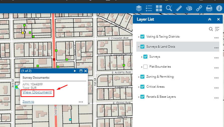

The county next door has their surveys linked on their web app, but they are using a paid service to create the links an we don't have a budget to do that.
When you click view document it opens the pdf

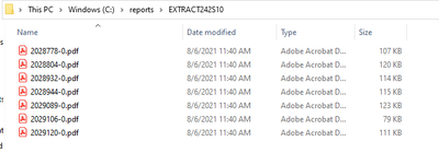

Here are the pdfs in the extract folder:

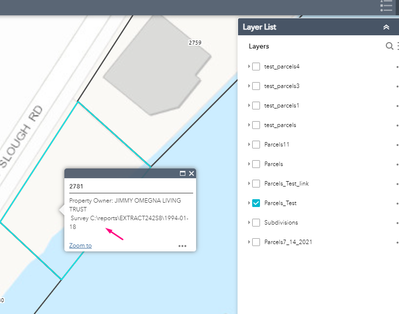

My attribute table in arc pro:
but they all just redirect me back to the web app in a new window.
If I don't use the link and just paste the file path in the cell, it doesn't create a hyperlink, but I am able to copy and paste the link in my browser and the pdf will open.
file:///C:/reports/EXTRACT242S10/2028778-0.pdf

Hey Lorraine, it looks like your hyperlink is missing part of the file path.
Your screenshot shows
<a href="C:\reports\EXTRACT232S9" target="_top">2028778-0</a>
instead of
<a href="C:\reports\EXTRACT232S10\2029778-0.pdf" target="_top">2028778-0</a>

I tried this, but it still was just opening the web app again when I clicked on the link.
