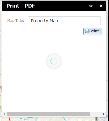

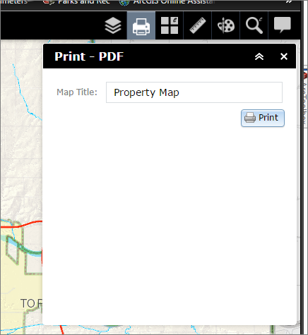

I had a user that was not seeing all of the options in the print widget, namely the advanced button and title, etc - print button does show up. Once I noticed they were using Chrome 52, I upgraded and that is the problem. I haven't found any other widgets that have been affected yet. The Print widget tries to load and then I get a time out message. It does work properly in IE11. As half my users are on Chrome - not good.
Property Search
Is there a fix for this? Has anyone else noticed?  Would upgrading to WAB DE 2.1 fix the issue?

  It is affecting 1.3, 2.0 and 2.1 sites. The workaround if to setup a proxy (if you have not dome so yet) and modify the Print.js file to have the _getPrintTaskInfo function esriRequest to use the proxy (line 17).

Thank you Robert, you saved the day again. I had to go through all the steps to set up the proxy first, but finally got all my apps back up and running.  BTW - esri support thinks you are a legend!
