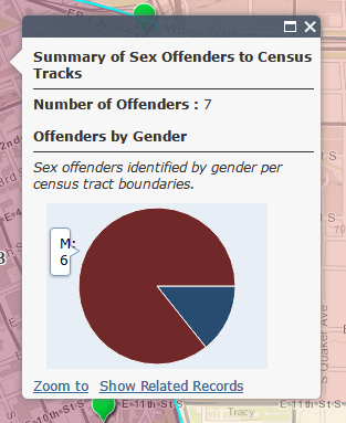

As you can see... the RED part of the pie chart has this tiny, broken pop-up bubble with a "M:6" which is SUPPOSED to render as 6 Males. It looks like crap?! Is there anything I can do to adjust this?

  Well that supper short field name is an issue. The one thing I have come up with is to set the min-width of the tooltip:
Add this rule to your themes style.css:
.claro .dijitTooltipLeft,
.claro .dijitTooltipRight {
    min-width: 60px !important;

I placed this in every style.css file in the map folder and got nothing... I'm so confused by the layout of the styles locations. I assumed that the WAB would only create a folder for the used version of a theme. I have a color folder for each styling of the themes... so confused.

But if I force it in Chrome to the inspector stylesheet? Works like a charm...

Apparently, I needed to double check my cache. It's that kind of day... the changes weren't making it through cache.
