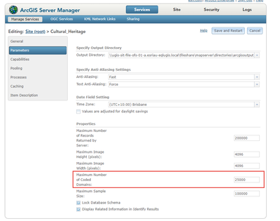

@fshih , there is an option in server manager where you can set the maximum number of coded domain descriptions which are returned in the service. The default value is 25,000. If you have more records than 25000 in the service which require you to view the descriptions of, you need to up this number.
Here is where you set this setting (Help Link😞

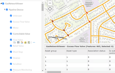

Shelley, Thanks for your help!  I do have the maximum number of coded domain set to 25,000.  My issue is, not even one of them is returned, I just see the Domain Code instead.  It also behaves this way in the web map (see screenshot below, Asset Group and Asset Type displaying 1).  If I use a feature service or a map service with feature access, the domain description will display.  However, I had to publish only the map service in order to get layer grouping and complex symbology working.. Does it work for you if publish only the map service without feature access?
