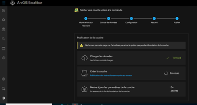

I'm trying to publish video services from Excalibur to ArcGIS Video Server.
When the default Item Store is configured on the File System, the hosted video layer publishes successfully.
However, when I set the default Item Store to the ArcGIS Data Store, publishing the hosted video layer results in a generic error in Excalibur. The Video Server logs display the following message:
"Impossible to connect to the object store. Error : Unable to execute HTTP request: Connect to xyzx failed: Connection refused: getsockopt"

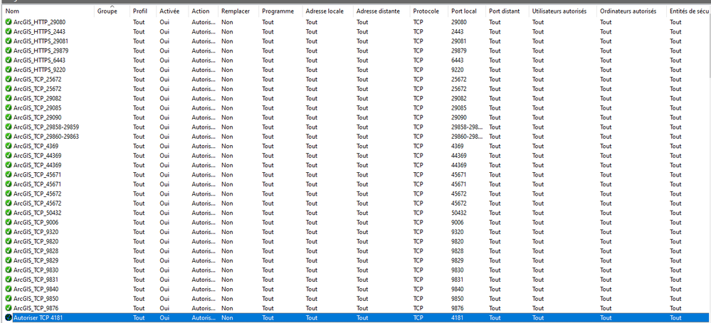

I’ve checked the ports and opened those mentioned here:
https://community.esri.com/t5/arcgis-video-server-questions/error-creating-layer/m-p/1596227#M19
But I still can’t publish the video layer.

Hi Joshua, thanks for the workflow,
  1. Yes, I opened all the ports required by the Data Store as well as 25672, 44369, 45671, and 45672 (TCP).
  2. I agree with your approach, but I’m struggling to pinpoint exactly what’s missing. Unfortunately, the logs are not very explicit this time—just the message: "Connection refused: getsockopt"
  3. I restarted the components in the order you mentioned and waited 5 minutes between each step.
    However, the publishing has been running for hours now, which I can’t explain, especially since the file is only 79 MB.
If possible, could you please try publishing the video on your side to see if it works? Or could this be a bug or product issue?
