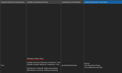

PaulLeBlanc1
I believe Manage IsDirty is False in the Sewer model, so that behavior is expected.
See https://pro.arcgis.com/en/pro-app/latest/help/data/utility-network/set-or-modify-the-subnetwork-defi... step 10

PaulLeBlanc1
JonathanDaweEsriUK
Hi Paul, thanks that makes sense, I don’t think I fully grasped the impact of that setting.
Out of interest, what is the use case for having Manage isDirty set to false like this?

PaulLeBlanc1
  1. During data migration / cleanup there isn't typically a need to track subnetwork state. There is a cost associated with this, so disable it to speed up the process.
  2. Subnetworks are required to define direction (eg for upstream/downstream traces). If there isn't a need to export subnetworks, then similar to #1, there isn't a need to track state.
