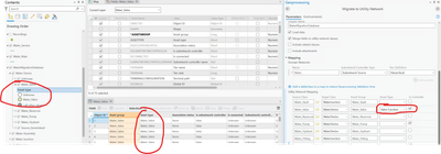

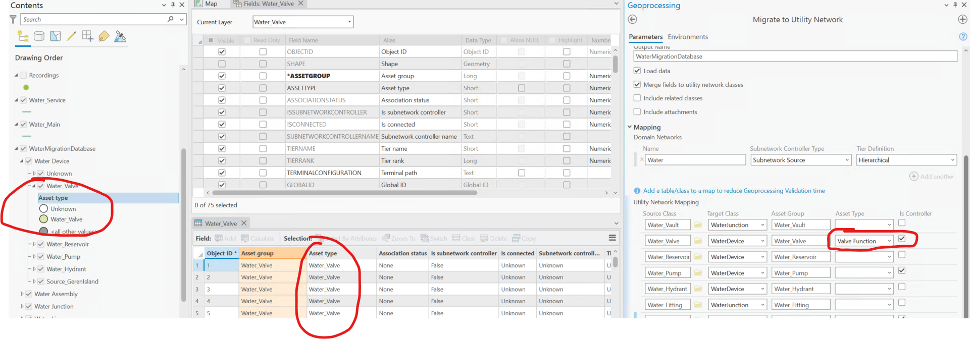

Working on our Water UN Prototype, and have successfully delineated all of our primary pressure zones. That felt like a big milestone! I’ve now gone back to the drawing board (re-running Migrate to Utility Network) to try to assign Asset Types to our Water Valves so that I can set Pressure Reducing Valves as subnetwork controllers for delineating our closed PRV subnetworks.
The tool seems to run fine using our “Valve Function” field as the Asset Type input. But after the tool completes, all water valves still have “Water_Valve” as the Asset Group and Asset Type. It’s not splicing or dicing the Asset Type based on the Valve Function field as I expected.

@RobertKrisher I did get this error:
 Coded value domain is not assigned or has no values for VALVEFUNCTION on Water_Valve
However the input data did have a coded value domain set for the field, it was just a string field with coded values versus an integer field.
