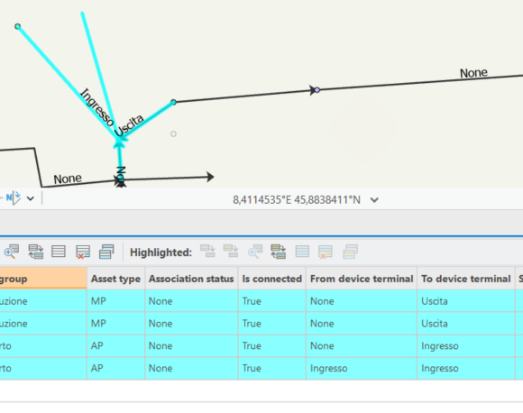

Hi all i have a doubt:
i'm currently working with an GAS UN custom and i have defined a direction terminal with 2 terminal (Input and Output). I notice that  i can have more than one line for both Input and output. Is this the correct workflow? I initially thought that I could connect only one line to one terminal, but it seems that I might have missed some rules.
As you can see, there are no topological or subnetwork errors.
Thanks
MikeMillerGIS
Esri Frequent Contributor
This is allowed, nothing restricts the cardinality.

DanieleChiara
@MikeMillerGIS there is a way to "force" only 2 line in a certain point? not only for the terminal i mean in general. In this specific case the PT->Modify Terminal Connections geoprocessing don't connect in the right way the line if the rule are not restrictive (if one point can connect in any terminal the tool don't follow the direction but make the connection at the first available terminal). i have to develop a custom way to connect correctly the terminal but i think can be usefull for all users that make the porting to UN.

DanieleChiara
@MikeMillerGIS so for porting there is no way to force.
