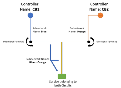

Sorry, I put the example of the Service but the thing is that what we are having now is all Assets within the two circuits with the information of the both Circuits stored in Feeder IDs fields. The schema of what I want to check if it is possible is the following:
Nowadays the Feeder Manager of ArcFM working against the GN allows to have 2 or more feeders supplying any asset downstream of the CB, having different IDs for any additional circuit. In the next example we see an Asset having two different circuits:
At the end, I would like to know how to properly model this in the UN because apparently, even if at the first glance, the Update Subnetwork allows to do it and populates correctly both the geometry and the two records in the ElectricSubnetLine and also it fills the field "Subnetwork Name" of all Assets downstream the CBs as well, the Tracing fails because of the error already commented above.
So at the end, either it is not possible to model it like that (and I understand because the power is actually coming from both of them) but then, in my opinion, the Update Subnetwork shouldn't work as well. Or, if it would be possible to do it so, then the Tracing Tools should work as well.
Hope I did myself a bit more clear and I really appreciate all your comments regarding this topic:)
JohnAlsup
Does the downward leg to the service actually (electrically) belong to both circuits?  The only way I could think of that being the case is it were getting one phase from CB 1 and another from CB 2, which is probably not what is occurring.  Is it actually the case where you have two physical lines running down to the service, each a separate line?

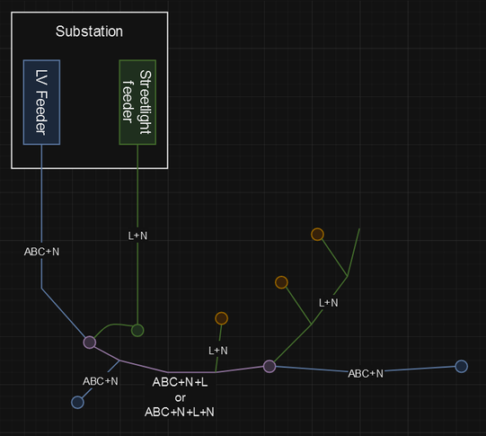

I have a similar case, where some lines in my network share conductors from two different circuits (one LV and one Streetlight) coming from two different feeders...
Here is a drawing of the case :
As you can see, the middle line is composed of several conductors from the two feeders, with or without a shared neutral. In this case, that middle line will get both subnetwork names, and the rest will have only one. Note that I do not model each conductor with edge objects.
I found it pretty similar to the topic described here, and wonder if this can be modeled with the partitioned domain.

PierreloupDucroix
MVP Regular Contributor
In this case, there is only one physical line (containing multiple wires, but as you suggested, I will not model non-spatial content) but two different circuits can pass through this line... This is the reality of the field.
I am thinking about switching to a hierarchical model, and then to have a tier for MV, and a tier group for LV containing one tier for LV electric distribution and one for LV Streetlight.
Do you think it makes sense ?

JohnAlsup
Hierachical won't help you here.  You will have to make this two seperate lines.
