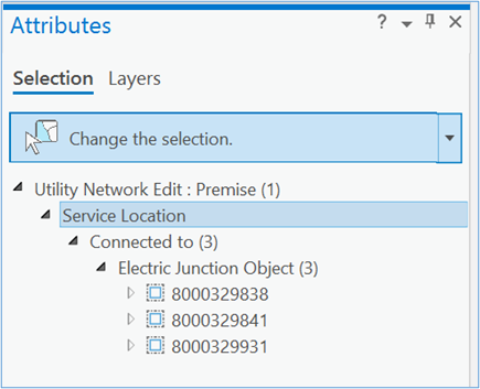

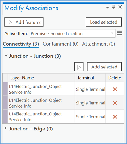

I am having difficulty with the modify associations view. In the junction-junction section of the connectivity tab, I am not able to change the display name of connected records. So I cant tell which feature each row relates to. And also when I right click, the "select" option doesnt actually select and there is no option to "flash".
Using arcgis pro v2.9.5 and UN v5. Any advice? tia

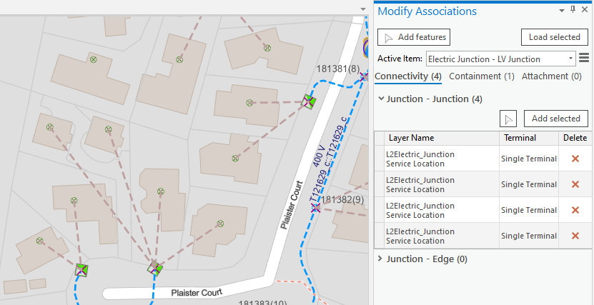

joecastellana
Thanks Mike, I can see thats how it should work but in many cases thats not how the app is working unfortunately. Im not sure if this is a common/known issue or some other blocker is present.
You can see in the two snips the modify associations display is different despite the same settings.

joecastellana
Thanks Mike. Yes I do have multiple layers managed w/ definition query including the Electric Junction Object table from the above screen shots. Is there possibly something Ive set up incorrectly, or some best practice I should follow to allow Modify Associations tool to work with this config?
MikeMillerGIS
Esri Frequent Contributor
Listing the Junction Object tables with def queries does cause issues with the association tools.  We do not split them up with def queries and just leave them as one table.  They are adding subtype group tables to 3.3 to resolve this issue, but for now, one table in the map is the best option.
