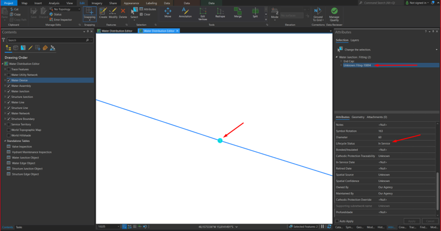

I would like to know if it is possible to exclude LifeCycle Status (Abandoned and Retired) from topology validations, I am facing a problem in my network because of this.

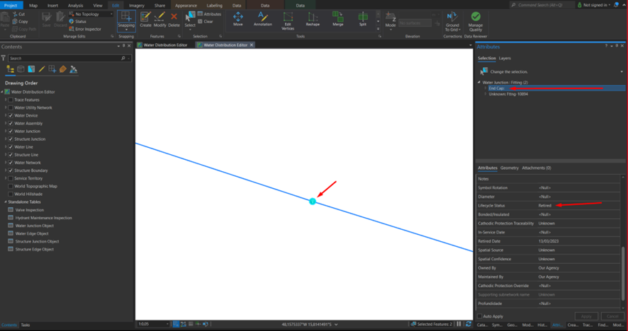

I have an End Cap that was retired, and I created another connection (unknown) in its place, in this case, the End Cap was "Retired" and the Fitting Unknown was "In Service".

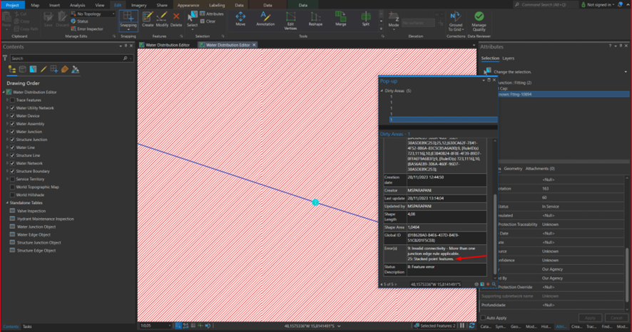

However, the following error is returning on my network, and the only solution I could find to resolve this error was to delete one of the connections, but, in the system, we must have both, because we need to maintain the history of our network.
Is there any configuration mode that does not consider some specific LifeCycle Status in topological validations?

No, A feature cannot be excluded from topology based on a network attribute.  It can only be set as a barrier to a subnetwork.

@MikeMillerGIS can correct me if I'm wrong, but I believe the recommended practice in this case is to offset the z-value of the retired asset (e.g. by -1) to avoid the conflict.

Yes, that is one way to exclude it from being connected.  Move all abandoned assets to a different Z

We also created a standalone feature class, outside of the network, which we can copy / paste the retired features into, which removes it from the topology.  The feature class is within the same database, and edit service, just outside the network. It works.
We haven't gotten to Z yet, which is why we went that route.

Take a look at the https://pro.arcgis.com/en/pro-app/latest/tool-reference/data-management/adjust-3d-z.htm tool.  This will shift the Z values for a selected set of features

We just finished a prototype of an Attribute Rule to lay down a set of classes to store abandoned assets and a set of attributes rules to move features to these classes and remove the abandoned assets.  If you want to test it out, try out the atbx here - https://github.com/Esri/Utility-Data-Management-Support-Tools/tree/Preview3.1.2
The GP tool is in the Attribute Rules toolset, call Create Abandon Classes.
