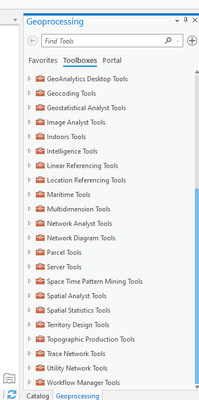

How I can get/download the Utility Network Package Tools for Arcgis pro?
Thanks in advance,
Alaa

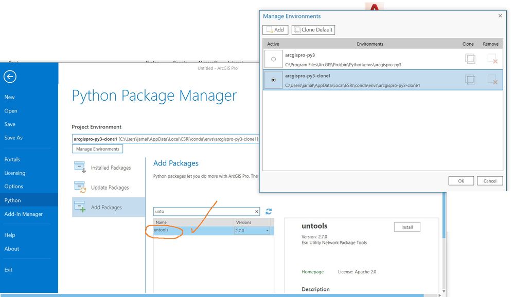

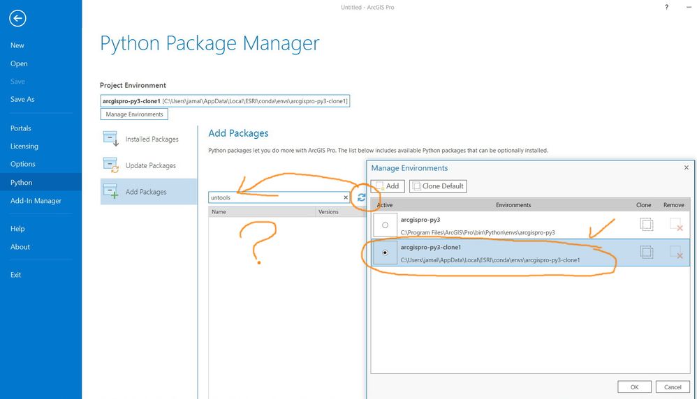

I ran into same issue! The “untools” doesn’t show up as it’s searched

Sorry about my late reply. Yo need to delete the clone environment and do the cloning again. After that it should work
JamalNUMAN
Legendary Contributor
Thank you for the help NahideAydin1. Deleing\re-adding the environment works fine

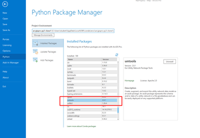

Hi,
I already install the untools package but I didn't see Utility Network Package Tools
I try delete and clone the environment so many times

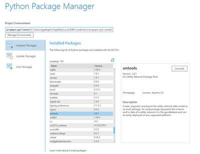

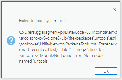

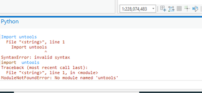

I am getting the same error when trying to download untools 2.8.1. I have removed all of the clones on my machine, then performed the following steps:
-Cloned active environment
-Closed and reopened Pro

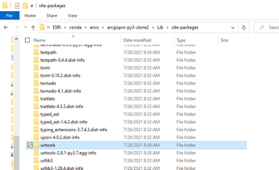

-Added untools 2.8.1 and confirmed it was installed by going to the Explorer directory. However it still showing the error that the untools module doesn't exist.
Is this a known issue for 2.8.1? Going to try installing untools 2.8 to see if the issue goes away.

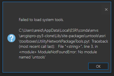

A coworker and I are getting the same results with 2.8.1. We have tried new cloned environments, one of them is on a completely fresh install of Pro 2.8.1 on a new computer. We've installed through Pro and through Python Command line. none of the methods result in anything except 'Failed to load system tools'
My screenshots look the same as wfrerichs's.
