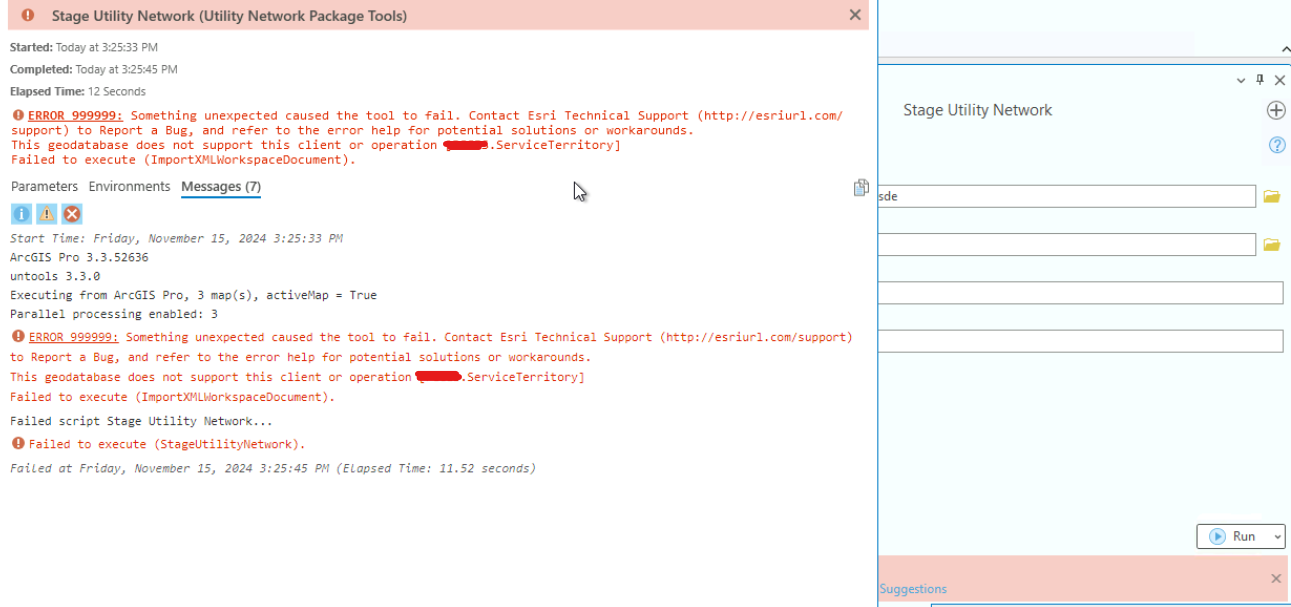

When trying to execute Stage Utility Network Geoprocessing tool in ArcGIS Pro, we are hitting Error:999999 and ImportXML failing.
In some testing we tried importing the Service Territory feature class from the asset package to this SDE, but it fails as well. Importing-Exporting any other layers(non-asset package) works without any issues.
What are we missing? We tried the same on a FGDB, and the UNM was created without any issues!!

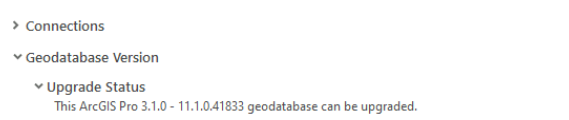

My guess is it is trying to create a 64bit object id, which was not supported in the 3.1 gdb.  Have you tried to run upgrade geodatabase?

I tried upgrading the SDE to 3.3 and the issue shows some progress.

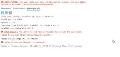

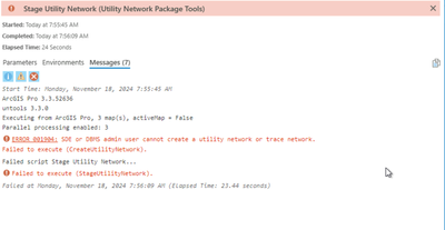

Now, the error is quite more precise, do we need any specific user requirement for creating a UNM?
To tackle this we created a new user named UNM with non dbo role and had create, update, delete permissions. This time it gave the same import failed permission error.
Is there anything specific this user is missing?

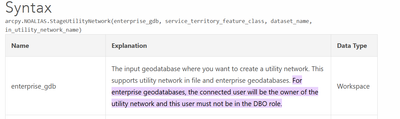

I am not sure, The user definitely cannot be a dbo, so check the permissions of the new user.
