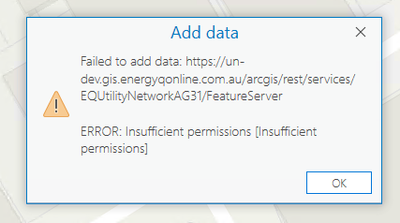

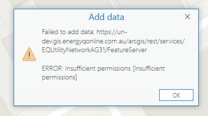

My next step is to create an ArcGIS Pro package that contains the map to allow of users to edit the Utility Network. When I add the feature service to a blank map within ArcGIS Pro, I get this error.

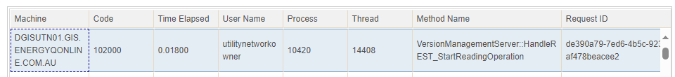

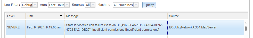

And the error as seen in the server logs (debug level enabled) that is from the UtilityNetwork server site (we have different server sites for workload segregation). These 2 pics show the whole log entry of that error.
When I tried to add the service in ArcGIS Pro, I was logged in as the UtilityNetwork Owner account in portal.
