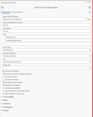

You need to add another tag, SubnetworkOverride
chiaramallegni_84
Hi Mike,
I'm probably doing something wrong but even with the SubnetworkOverride tag the result is the same: null geometry. (These are some more tests I did: SubnetworkOverride set as first tag, SubnetworkOverride set as second tag, SubnetworkOverride set as single tag).
MikeMillerGIS
Esri Frequent Contributor
Your trace type is downstream, the will only load trace types of Subnetwork.  Do you want to use a downstream trace?  I can remove that restriction.
