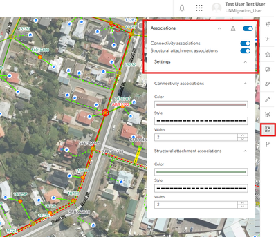

@kcoonen- If I have understood the question correctly, I think you are wanting to see if these associations can be seen visually on the map.
If you are working in ExB

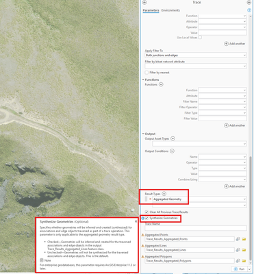

If you want the traces to show the association, this can be done by adding the result type of aggregated geometry and selecting the "synthesize geometries" in the trace configuration that you publish/
This is will draw the lines between elements that have connectivity associations or structural attachments.

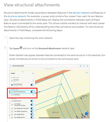

If you are working in FieldMaps - There is an option to toggle these on/off.
https://doc.arcgis.com/en/field-maps/ios/use-maps/utility-network.htm
If you are working within web editor or WebMap Viewer - There is a similar option to toggle this, on and off.
