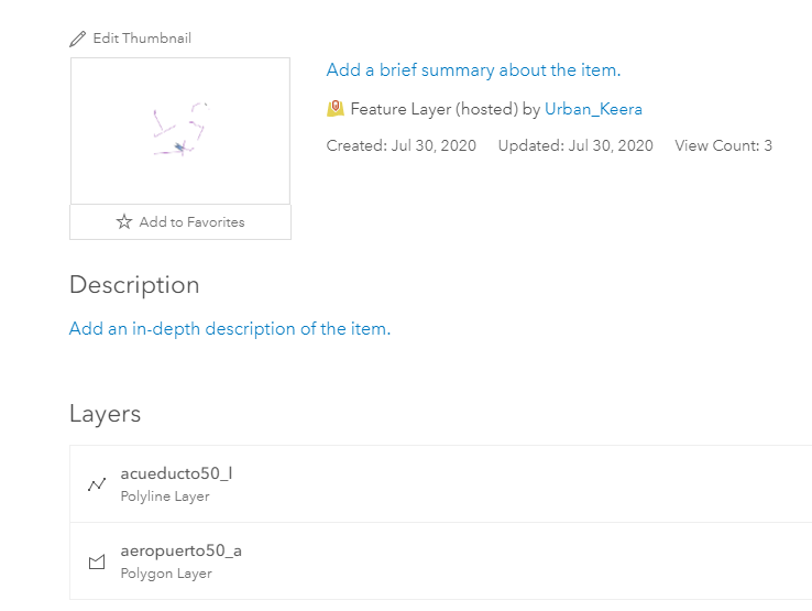

Jason and I discovered the issue was uploading a zipped shapefile to AGOL with two files inside it. The file uploads and publishes as one feature service, but when you open it in the map viewer, there are two "sub-layers" if you like. ArcGIS Urban does not like! Urban totally ignores the service - so much so, it doesn't even show up as an option to select. Here's a picture one a test shapefile I uploaded today.
Hosted Feature layer with two "sub-layers"This is kind of a cool way to publish several shapefiles at once - just not a format ArcGIS Urban needs for it's data model.

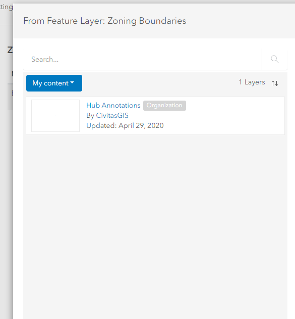

Zoning, land use, and parcel boundaries can be imported from hosted feature layers. Please be aware that some layers such as the zoning boundaries and the land-use boundaries require that you import zoning types and land use types first. You can also find additional information about the import of data in this section of the ArcGIS Urban online documentation.
In the portal item picker that is shown in the screenshot you've shared, you can configure where you want to search for your layers data. If you want to import data from a hosted feature layer that is only available to you, select the "My content" option from the button below the search bar. If you want to search through the whole content that is shared with your ArcGIS Online organization, select the "My organization" option.
Let us know if you are having further questions.

Hi all ,
